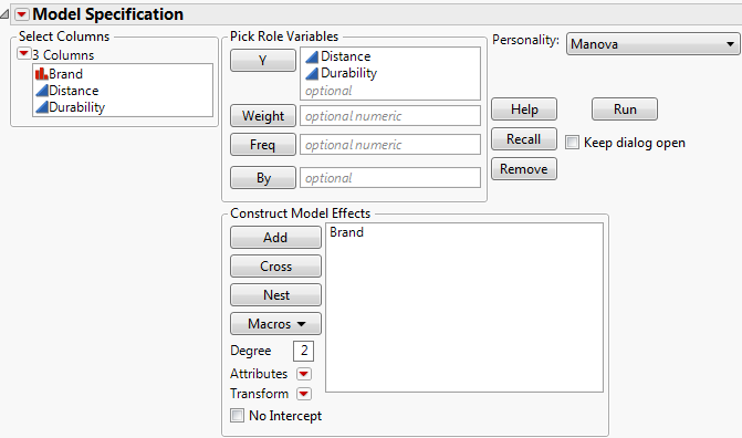

Select Brand and click Add.
5.
For Personality, select Manova.
Figure 8.1 Manova Setup

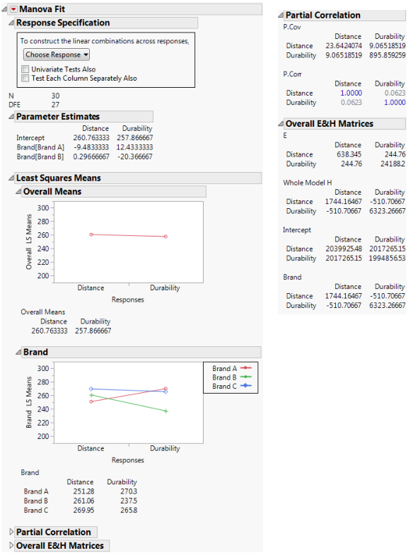

Click Run.
Figure 8.2 Manova Report Window
