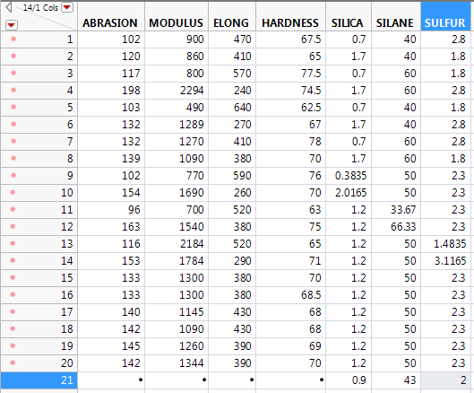

1.
2.
Enter 1 in the How many rows to add box and click OK.
3.
Under the SILICA column, type 0.9 in the box for the new row.
4.
Under the SILANE column, type 43 in the box for the new row.
5.
Under the SULFUR column, type 2 in the box for the new row.
Figure 2.34 Values for New Row
