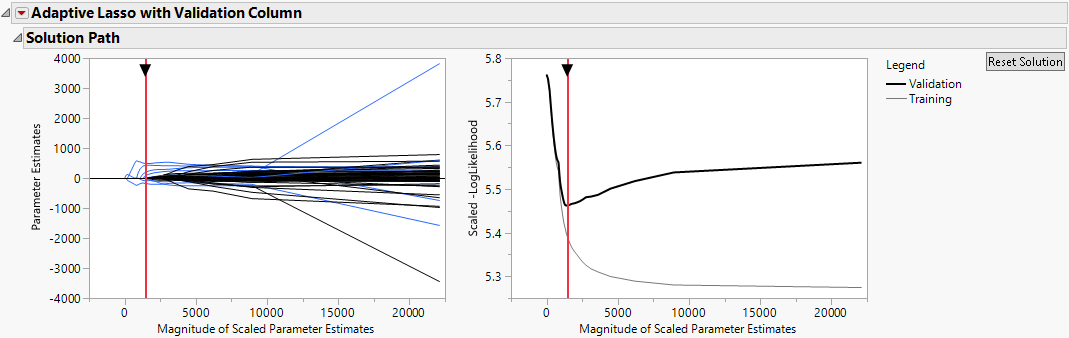

An Adaptive Lasso with Validation Column report appears. The Solution Path report (Figure 5.2) shows plots of the parameter estimates and scaled negative log-likelihood. The shrinkage increases as the Magnitude of Scaled Parameter Estimates decreases. The estimates at the far right of the plot are the maximum likelihood estimates. A vertical red line indicates those parameter values selected by the validation criterion, in this case, the holdback sample defined by the column Validation.
Figure 5.2 Solution Path Plot

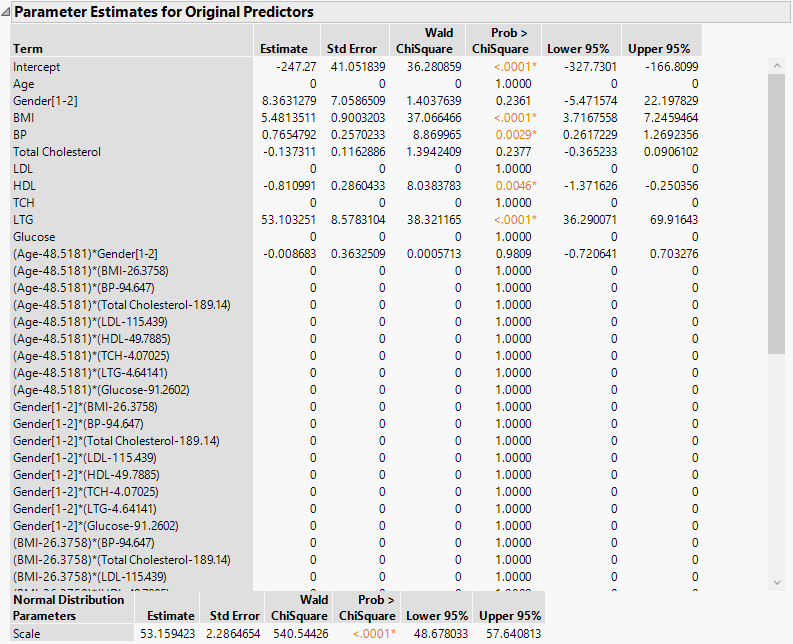

Select the option Select Nonzero Terms from the Adaptive Lasso with Validation Column report’s red triangle menu.
This option highlights the nonzero terms in the Parameter Estimates for Original Predictors report (Figure 5.3) and their paths in the Solution Path Plot. The corresponding columns in the data table are also selected. Note that only 7 of the 55 parameter estimates are nonzero. Also note that the scale parameter for the normal distribution (sigma) is estimated and shown in a separate table at the bottom of the Parameter Estimates for Original Data report.
Figure 5.3 Portion of Parameter Estimates for Original Predictors Report
