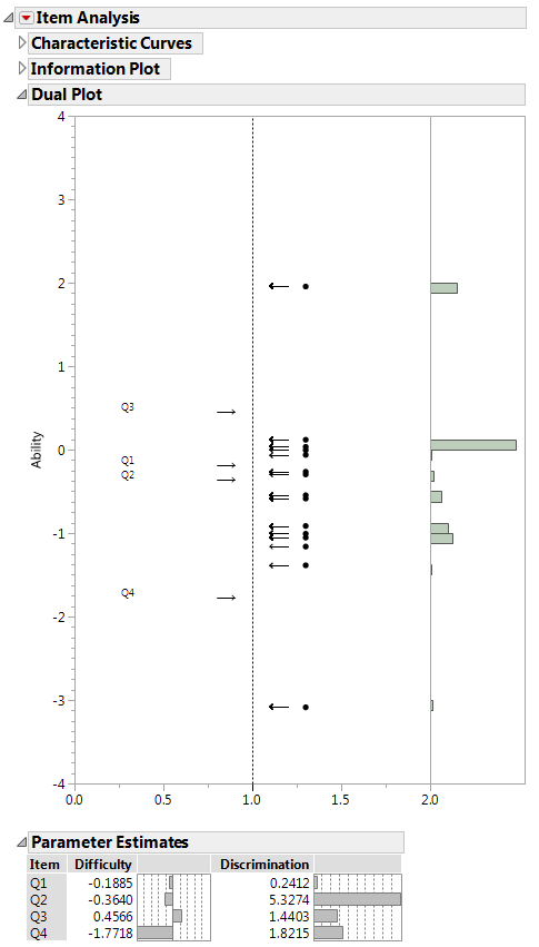

Figure 9.2 Item Response Report

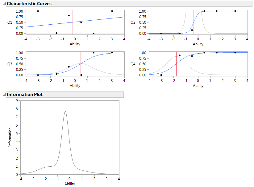

Click the Item Analysis red triangle menu, and select Number of Plots Across.
6.
Figure 9.3 Item Response Example
