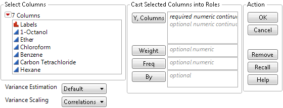

Launch the Factor Analysis platform by selecting
Analyze > Multivariate Methods > Factor Analysis
Figure 7.4
Factor Analysis Launch Window
Y, Columns
The columns to be analyzed. These must have a Numeric data type.
Weight
A column containing a weight for each observation in the data table. A row is included in the analyses only when its value is greater than zero.
Freq
Assigns a frequency to each row in the analysis. This is useful when your data are summarized.
By
Variance Estimation
Lists the methods for estimating the variance-covariance matrix for the analysis. For more information about the methods, see
The Multivariate Report
Variance Scaling
Lists the scaling methods for performing the factor analysis.
Correlations
Default method that enables analysis on correlations.
Covariances
Enables the analysis on a weighted correlation matrix where the weights are the variables’ variances.
Unscaled
Enables the analysis of variables that are already centered or scaled.
