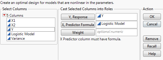

With your starting data table active, select
DOE > Special Purpose > Nonlinear Design
Figure 22.15
Nonlinear Launch Window
Y, Response
The numeric column for response values.
X, Predictor Formula
The numeric column that contains the formula for the nonlinear model. This formula must contain parameters.
Weight
(Optional) A numeric column that assigns weights to the observations.
