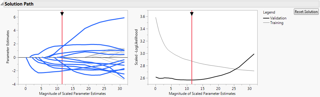

The Solution Path is shown in Figure 6.1. The paths for terms that have nonzero coefficients are highlighted. Think of the solution paths as moving from right to left across the plot, as the solutions shrink farther from the MLE. A number of terms have paths that shrink them to zero fairly early.
Figure 6.1 Solution Path for Lasso Fit with Nonzero Terms Highlighted

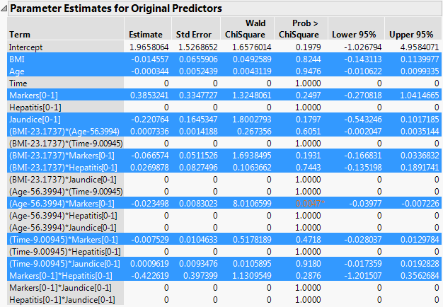

The Parameter Estimates for Original Predictors report (Figure 6.2) shows the parameter estimates for the uncentered and unscaled data. The 11 terms with nonzero parameter estimates are highlighted. These include interaction effects. In the data table, all six predictor columns are selected because every predictor column appears in a term that has a nonzero coefficient.
11.
Click on the row for (Age - 56.3994)*Markers[0-1] in the Parameter Estimates for Original Predictors report.
Figure 6.2 Parameter Estimates Report with Nonzero Terms Highlighted
