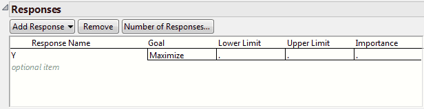

Figure 12.3 Responses Outline
The name of the response. When added, a response is given a default name of Y, Y2, and so on. To change this name, double-click it and enter the desired name.
The Goal tells JMP whether you want to maximize your response, minimize your response, match a target, or that you have no response goal. JMP assigns a Response Limits column property, based on these specifications, to each response column in the design table. It uses this information to define a desirability function for each response. The Profiler and Contour Profiler use these desirability functions to find optimal factor settings. For further details, see Desirability Profiling and Optimization in the Profilers book and Response Limits in Column Properties.
Note: If your target response is not midway between the Lower Limit and the Upper Limit, you can change the target after you generate your design table. In the data table, open the Column Info window for the response column (Cols > Column Info) and enter the desired target value.
The Goal, Lower Limit, Upper Limit, and Importance that you specify when you enter a response are used in finding optimal factor settings. For each response, the information is saved in the generated design data table as a Response Limits column property. JMP uses this information to define the desirability function. The desirability function is used in the Prediction Profiler to find optimal factor settings. For further details about the Response Limits column property and examples of its use, see Response Limits in Column Properties.
If you do not specify a Lower Limit and Upper Limit, JMP uses the range of the observed data for the response to define the limits for the desirability function. Specifying the Lower Limit and Upper Limit gives you control over the specification of the desirability function. For more details about the construction of the desirability function, see Desirability Profiling and Optimization in the Profilers book.
