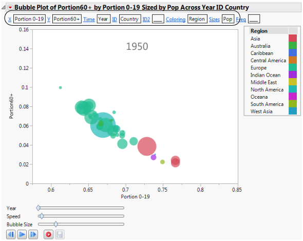

Follow the instructions in Example of a Dynamic Bubble Plot to produce the report window shown in Figure 7.6. (The colors are the JMP default colors.)
Figure 7.6 Example of Bubble Plot with Show Roles Selected
To change the variable assigned to a role, click on a blue underlined role name. For example, in Figure 7.6, to change the Coloring variable from Region to Country, proceed as follows:

Country now replaces Region as the Coloring variable in the bubble plot.
To remove an existing variable from the bubble plot, make sure that nothing is selected in the Select column for <Role> window, and click OK. For example, in Figure 7.6, to remove the Sizes variable (Pop), proceed as follows:
