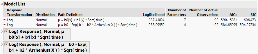

The Destructive Degradation report contains an outline for each model that you fit. When you fit a model, the Model List is updated with a row for that model.

Model List and Model Outlines
Model List
The first three columns in the Model List reflect the choices that you made in the plot options. The -Loglikelihood, AICc, and BIC statistics are information-based measures that can be used for model comparisons. For descriptions of these measures, see
The three information-based measures in the Model List are comparable across models as long as the models being compared have the same Number of Actual Observations. If this is not the case, exercise caution because different models might use different subsets. The Number of Actual Observations might be reduced due to the choice of distribution or the choice of transformation. Choosing a log-location-scale distribution excludes all non-positive Y values. Also, the Log and Sqrt transformations exclude all non-positive values.
