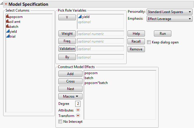

Open Popcorn.jmp. You are interested in whether popcorn and batch have an effect on yield.
1.
Select Analyze > Fit Model.
4.
Select Macros > Full Factorial.
Figure 1.10 Fit Model Window for Two-Way Analysis of Variance with Interaction

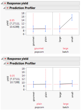

Figure 1.11 shows a profiler plot of the fit for this example. To obtain this plot, click Run in the Fit Model window shown in Figure 1.10. Then, from the red triangle menu for the Fit Least Squares report, select Factor Profiling > Profiler.
In the top plot, popcorn is set to gourmet, and in the bottom plot, it is set to plain. Note how the predicted values for the settings of batch depend on the type of popcorn. This is a consequence of the interaction between popcorn and batch.
Figure 1.11 Model Fit for a Two-Way Analysis of Variance with Interaction
