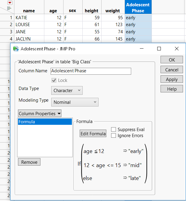

How do you create a formula column that combines conditional expressions with value comparisons? Create a Formula Column.jsl shows how to create a new formula column that evaluates ages in Big Class.jmp and returns the result in the new column (Figure 17.3).

dt << New Column( "Adolescent Phase",
	Character,
	Formula(
		If( :age <= 12, "early",
			12 < :age <= 15, "mid",
			"late"
Figure 17.3 Conditional Expression in Formula
