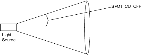

To create a spotlight, limit the shape of the light to a cone. Use the SPOT_CUTOFF argument to define the side of the cone, as shown in the following illustration.
Figure 13.16 Spotlight
In addition to the cutoff angle, you can control the intensity and direction of the light distribution in the cone. SPOT_DIRECTION specifies the direction for the spotlight to point; SPOT_EXPONENT influences how concentrated the light is.
