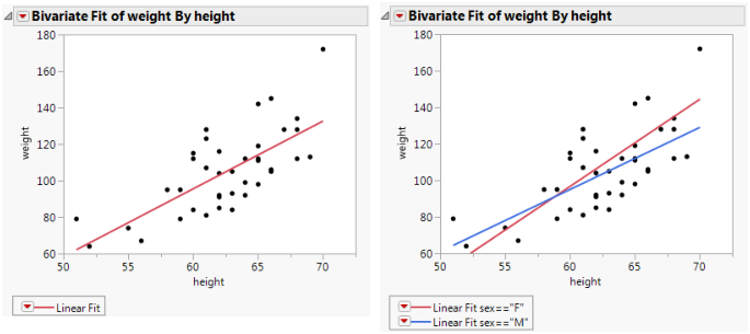

Use a grouping variable to overlay regression lines to compare slopes of the different groups.
4. Select height and click X, Factor.
5. Click OK.
To create the example on the left in Figure 5.24:
6. Click the red triangle next to Bivariate Fit of weight By height and select Fit Line.
To create the example on the right in Figure 5.24:
7. From the Linear Fit menu, select Remove Fit.
8. Click the red triangle next to Bivariate Fit of weight By height and select Group By.
9. From the list, select sex.
10. Click OK.
11. Click the red triangle next to Bivariate Fit of weight By height and select Fit Line.
Figure 5.24 Example of Regression Analysis for Whole Sample and Grouped SampleĀ
The scatterplot to the left in Figure 5.24 has a single regression line that relates weight to height. The scatterplot to the right shows separate regression lines for males and females.
