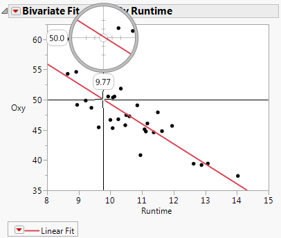

Use the crosshair tool as described below to approximate the Runtime value that results in a mean Oxy value of 50.
7. Select Tools > Crosshairs.
8. Click the Oxy axis at about 50 and then drag the cursor so that the crosshairs intersect with the prediction line.
Figure 3.34 shows that a Runtime of about 9.77 gives an inverse prediction of about 50 for Oxy.

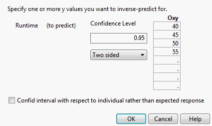

5. Click the Response Oxy red triangle and select Estimates > Inverse Prediction.
6. Enter four values for Oxy as shown in Figure 3.35.
7. Click OK.
Figure 3.35 Completed Inverse Prediction Specification Window

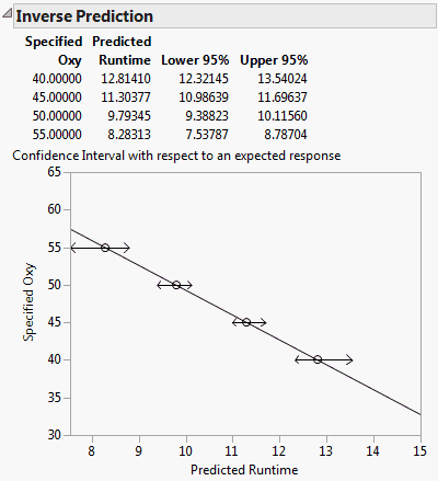

The Inverse Prediction report gives predicted Runtime values that correspond to each specified Oxy value. The report also shows upper and lower 95% confidence limits for these Runtime values, relative to obtaining the mean response.
Figure 3.36 Inverse Prediction Report
The exact predicted Runtime resulting in an Oxy value of 50 is 9.7935. This value is close to the approximate Runtime value of 9.77 found in the Bivariate Fit report shown in Figure 3.34. The Inverse Prediction report also gives a plot showing the linear relationship between Oxy and Runtime and the confidence intervals.

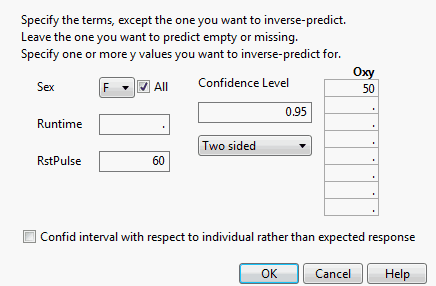

6. Delete the value for Runtime, because you want to predict that value.
7. Select the All box next to Sex to estimate Runtime for all levels of Sex.
8. Replace the mean for RstPulse with 60.
9. Enter the value 50 for Oxy as shown in Figure 3.37.
10. Click OK.

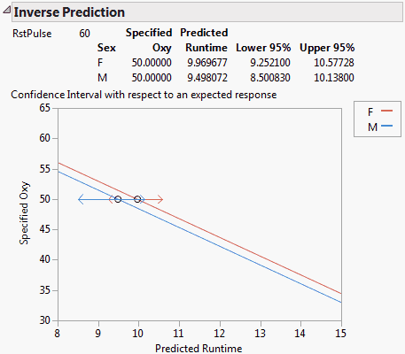

The report, shown in Figure 3.38, gives the predicted values of Runtime for both females and males. The report also includes 95% confidence intervals for Runtime values that give a mean response of 50.
Figure 3.38 Inverse Prediction Report for a Multiple Regression Model
The plot shows the linear fits for females and males, given that RstPulse is 60. The two confidence intervals are shown in red and blue, respectively.
