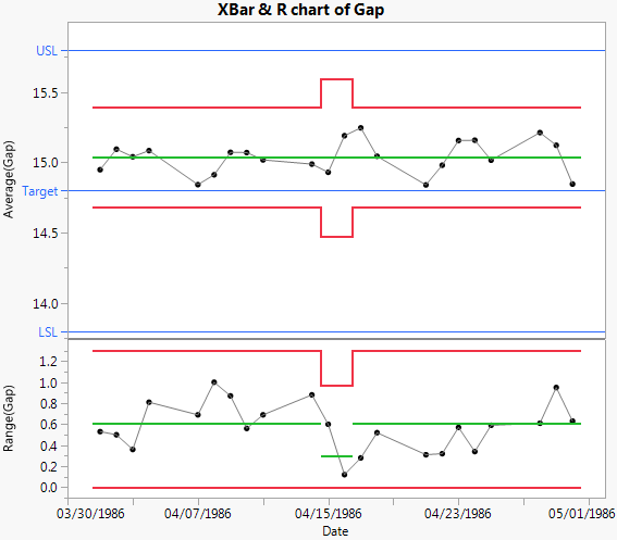

3. Drag Date to the Subgroup zone.
4. Drag Gap to the Y zone.
Figure 7.21 XBar and R Control Chart for Gap
The control chart indicates that Gap is stable over time. Because Gap has the Spec Limits column property, a Process Capability Analysis report appears to the right of the control chart.

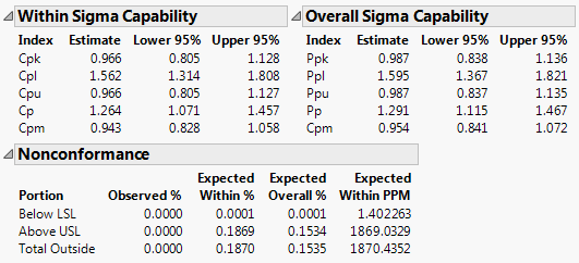

5. Right-click in the body of the Nonconformance report and select Expected Within PPM from the Columns submenu.
Figure 7.23 Capability Indices and Nonconformance Report
The Cpk value calculated using subgroup variation is 0.966, indicating that the process is not very capable. The Cpl value suggests good performance, but this is because the process is shifted away from the lower specification limit. Defective parts generally result from large values of Gap.
Note that the confidence interval for Cpk is wide; it ranges from 0.805 to 1.128. This occurs even though there are 104 observations. Capability indices are surprisingly variable, due to the fact that they are ratios. It is easy to reach incorrect conclusions based on the point estimate of a capability index.
The estimates of out-of-specification product given in the Nonconformance report provide a direct measure of process performance. The PPM values in the Nonconformance report indicate that Gap hardly ever falls below the lower specification limit (1.4 parts per million). However, the number of parts for which Gap falls above the upper specification limit is 1869.0 parts per million.
For an uncentered process, the Cp value indicates potential capability if the process were adjusted to be centered. If this process were adjusted to be centered at the target value of 14.8, then its capability would be 1.264, with a confidence interval from 1.071 to 1.457.

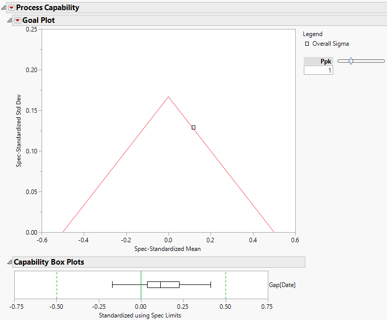

Figure 7.24 Goal Plot and Box Plot for Gap
The Goal Plot shows the Ppk index for Gap as being essentially equal to 1. The box plot shows that most values fall within specifications, but the preponderance of data values are shifted to the right within the specification range.
