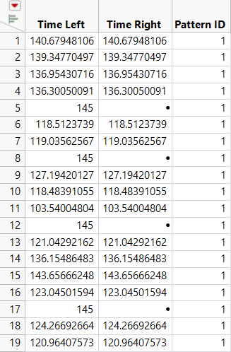

Figure 5.8 Simulation Configuration PanelĀ

Figure 5.9 Partial Results of SimulationĀ
Figure 5.9 shows a partial listing of the simulated data table. The stress pattern with Pattern ID equal to 1 is defined only up to 145 time units. Since the Pattern Configuration setting in the launch window was set to Terminate, the simulation censors any simulated values at 145 for stress pattern 1.
