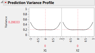

9. Open the Design Evaluation > Prediction Variance Profile outline.
Figure 5.41 Prediction Variance Profile for I-Optimal Model
The relative prediction variance of the expected response is smallest in the center of the design space.

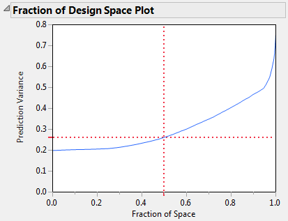

10. Open the Fraction of Design Space Plot outline.
The Fraction of Design Space Plot appears on the left in Figure 5.44. When the Fraction of Space is 0.95, the vertical coordinate of the blue curve is about 0.5. This means that for about 95% of the design space, the relative prediction variance is below 50% of the error variance.

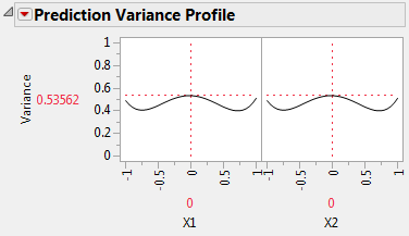

7. Open the Design Evaluation > Prediction Variance Profile outline.
Figure 5.43 Prediction Variance Profile for D-Optimal Model
At the center of the design region, the relative prediction variance is 0.53562, as compared to 0.208333 for the I-optimal design (Figure 5.41). This means that the relative standard error is 0.732 for the D-optimal design and 0.456 for the I-optimal design. All else being equal, at the center of the design region, confidence intervals for the expected response based on the D-optimal design are about 60% wider than those based on the I-optimal design.
The Design outline shows that the D-optimal design has nine design points, one for every combination of X1 and X2 set to -1, 0, 1. The D-optimality criterion attempts to keep the relative prediction variance low at each of these design points. Explore the variance at the extremes of the design region by moving the sliders for X1 and X2 to -1 and 1. Note that the variance at these extreme points is usually smaller than the variance for the I-optimal design at these points.

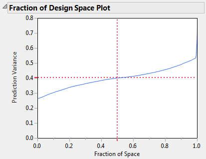

8. Open the Design Evaluation > Fraction of Design Space Plot outline.
The Fraction of Design Space Plot appears on the right in Figure 5.44.
Figure 5.44 Fraction of Design Space Plots (I-Optimal on left, D-Optimal on right)
The red cross-hairs in each plot indicate the maximum prediction variance for 50% of the design space. For 50% of the design space, the prediction variance for the I-optimal design falls below about 0.27. For the D-optimal design, the prediction variance is about 0.4.

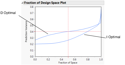

Figure 5.45 Fraction of Design Space Plots Superimposed
The variance curve for the I-optimal design is below the curve for the D-optimal design over at least 90% of the design space. This reflects the fact that I-optimality attempts to minimize prediction variance over all of the design space. In contrast, D-optimality focuses on reducing prediction variance at the design points.
