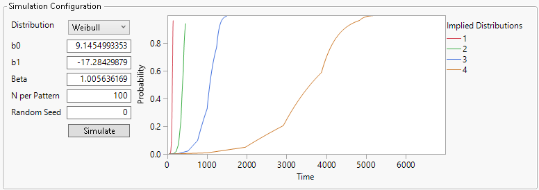

The Simulation Control Panel
Figure 5.7 shows the Simulation Configuration Panel. The initial values for Distribution and the parameter settings are determined by the parameter estimates for the distribution specified in the Cumulative Damage launch window. The graph shows the estimated failure distribution functions over time for the stress patterns defined in the Stress Pattern data table.
Figure 5.7 Simulation Configuration Panel
The Simulation Configuration panel enables you to simulate new failure time data based on a distribution and stress pattern. The stress pattern defined in the Stress Pattern data table used in the launch of the platform is also used for the simulation. This panel contains the following options:
Distribution
The distribution to be used for the simulation. The available distributions are the same as in the Cumulative Damage launch window. For more information about the distributions, see Distributions in the Life Distribution section.
b0
The intercept for the location parameter of the distribution.
b1
The slope for the location parameter of the distribution.
lambda
(Available only for the Box-Cox relationship.) The lambda value for the Box-Cox relationship.
b2, s0, s1, and so on
(Available only for the Custom relationship.) Other parameters that are defined in the Custom relationship in the Cumulative Damage launch window.
Beta
(Available only for the Weibull distribution.) The Beta parameter of the Weibull distribution.
sigma
(Available only for the Lognormal, Loglogistic, and Fréchet distributions.) The sigma parameter of the distribution.
N per Pattern
The number of points generated in the simulation for each stress pattern.
Random Seed
(Optional) A nonzero random seed that ensures the reproducibility of simulation results.
Termination
(Not available when the specified Pattern Continuation in the Cumulative Damage launch window is Terminate.) A time beyond which surviving test units are censored.
Simulate
The plot in the Simulation Configuration panel shows the implied distributions for each of the stress patterns over time. Click the Simulate button to generate a new JMP data table that contains the results of the simulation.
