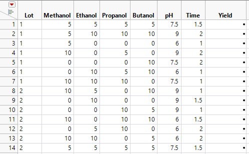

10. Click Make Table.
Note: The runs in your design might appear in a different order than the order shown in Figure 7.8.
Figure 7.8 Definitive Screening Design with Block for Extraction Process
Notice that run 1 is a center point run in Lot 1 and run 14 is a center point run in Lot 2.

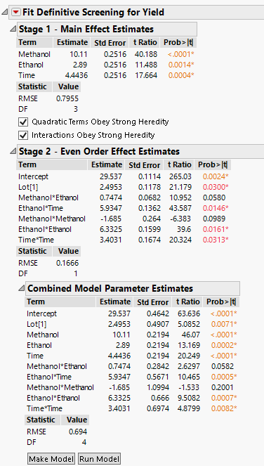

Analyze the Experimental Data
At this point, you conduct your experiment and record your data in the Yield column of the design table (Figure 7.8). The Extraction2 Data.jmp sample data table contains your experimental results. The runs in the Extraction2 Data.jmp sample data table are in a different order than those in Figure 7.8.
To explore all second-order effects, one option is to use All Possible Models regression. Another option is to use forward stepwise regression. However, these standard methods often fail to identify active effects. For this reason, you use the Fit Definitive Screening platform.

Figure 7.9 Fit Definitive Screening Report
The effects identified by Fit Definitive Screening as potentially active are listed in the Combined Model Parameter Estimates report.
3. Click the Run Model button at the bottom of the Combined Model Parameter Estimates report.
This fits a standard least squares model to the effects identified as potentially active.

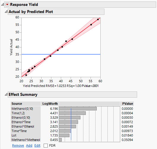

Figure 7.10 Standard Least Squares Report
The Actual by Predicted Plot shows no evidence of lack of fit. The Effect Summary report shows that Methanol*Methanol is not significant. You decide to remove this effect from the model.
4. Select Methanol*Methanol in the Effect Summary report and click Remove.

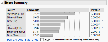

Figure 7.11 Final Set of Active Effects
The remaining effects are all significant. You conclude that these are the active effects.
