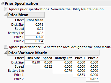

5. From the Untitled table, enter the values in the Estimate column into the Prior Mean outline in the Choice Design window (Figure 18.9).
You can copy and paste the entire column from the Untitled table, then click in the Disk Size text box under Prior Mean in the Prior Mean outline, right-click, and select Paste.
6. From the Untitled table, enter the values in the Std Error^2 column into the diagonal entries in the Prior Variance outline in the Choice Design window (Figure 18.9). Enter these one-by-one, rounded to three decimal places.
Figure 18.9 Prior Mean and Variance Information from Pilot Study
