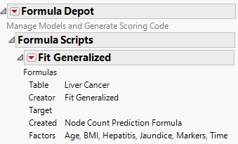

3. Click the red triangle next to Poisson Adaptive Lasso with Validation Column and select Save Columns > Publish Prediction Formula.
This option opens a Formula Depot that contains the prediction formula for the Fit Generalized model.
4. To add the prediction formula to the data table, select Run Script from the Fit Generalized - Node Count red triangle in the Formula Depot.

Figure 12.2 Formula Depot with a Generalized ModelĀ
