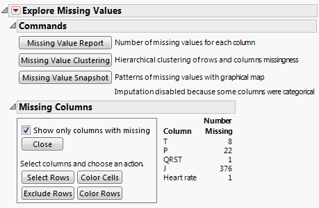

Figure 20.11 Missing Value ReportĀ
The Missing Columns report shown in Figure 20.11 indicates that only five columns have missing data. Out of a total of 452 rows, Column J has 376 missing values. Because it is largely missing, imputed values might not result in a meaningful analysis. For such data, you could explore a model using the Informative Missing option for Column J in a platform that supports the Informative Missing option.
Note that the two Imputation options, Multivariate Imputation and Multivariate SVD Imputation, are not shown. A message indicates that imputation is disabled because some columns included in the analysis were categorical. The data table contains several columns that are numeric, but have a nominal modeling type. These cannot be used for imputation.

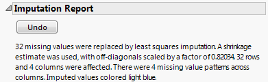

Figure 20.12 Imputation ReportĀ
Imputation Report
The Imputation Report indicates how many missing values were imputed and the specific imputation details. No missing data remain in the four columns that had missing values.
