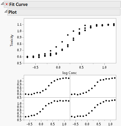

The Fit Curve Report appears. The Plot report contains an overlaid plot of the fitted model of each formulation.
Figure 13.2 Initial Fit Curve Report

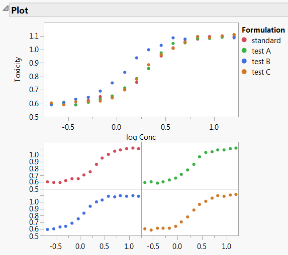

7. To see a legend identifying each drug formulation, right-click one of the graphs and select Row Legend. Select Formulation for the column and click OK.
Figure 13.3 Fit Curve Report with Plot Legend

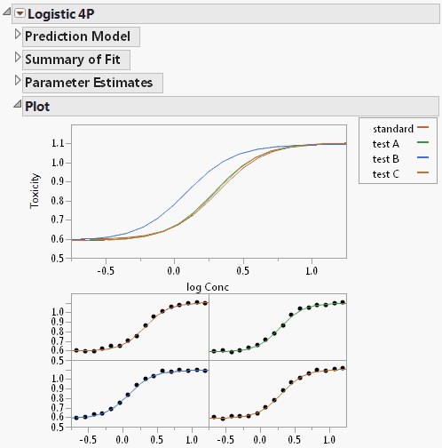

8. Click the Fit Curve red triangle and select Sigmoid Curves > Logistic Curves > Fit Logistic 4P.
Figure 13.4 Logistic 4P Report
The Logistic 4P report appears. There is also a separate plot for each drug formulation. The plot of the fitted curves suggests that formulation B might be different, because the test B curve starts to rise sooner than the others. Inflection point parameters cause this rise.

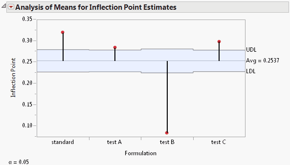

9. Click the Logistic 4P red triangle and select Compare Parameter Estimates.
Figure 13.5 Parameter Comparison Report
Notice that the Inflection Point parameter for the test B formulation is significantly lower than the average inflection point. This agrees with the plots shown in Figure 13.4. Drug formulation B has a higher toxicity ratio than the other formulations.
