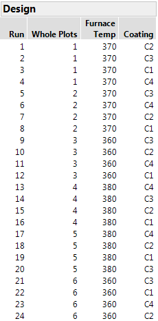

The Design outline for a 24-run custom design for the Box Corrosion Split-Plot.jmp experiment is shown in Figure 3.21. Because Changes for Furnace Temp was specified as Hard, a Whole Plots factor is constructed to represent the random blocks of settings for Furnace Temp.
Figure 3.21 Design Outline for Box Corrosion Split-Plot Experiment
