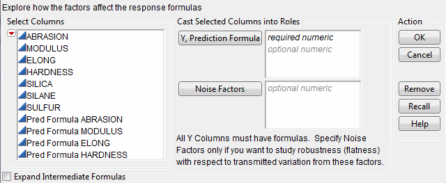

Profiler Launch Windows
When a profiler is invoked as a platform from the Graph menu, rather than through a fitting platform, you provide columns with formulas as the Y, Prediction Formula columns. These formulas could have been saved from the fitting platforms.
Figure 2.3 Profiler Launch Window
The columns referenced in the formulas become the X columns (unless the column is also a Y).
The response columns containing formulas.
Noise Factors
Used only in special cases for modeling derivatives. For more information about noise factors, see Noise Factors.
Expand Intermediate Formulas
Tells JMP that if an ingredient column to a formula is itself a formula column that refers to other columns, to substitute the original columns into the inner formula. To prevent an ingredient column from expanding, add an Other column property, name it Expand Formula, and assign a value of 0. See Expand Intermediate Formulas.
