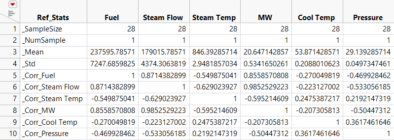

Figure 10.3 Target Statistics for Steam Turbine Data
2. Save the new data table as Steam Turbine Targets.jmp.

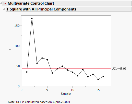

Figure 10.4 Steam Turbine Control Chart
Figure 10.4 shows out-of-control conditions occurring at observations 2, 3, 4, 5, and 8. This result implies that these observations do not conform to the historical data from Steam Turbine Historical.jmp, and that the process should be further investigated. To find an assignable cause, you might want to examine individual univariate control charts or perform another univariate procedure.
