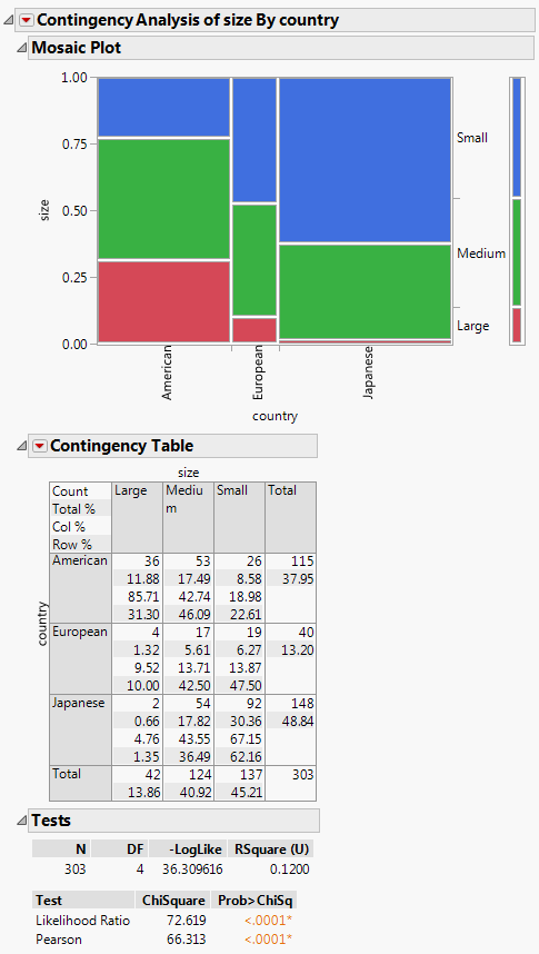

To produce the plot shown in Figure 7.4, follow the instructions in Example of Contingency Analysis.
Figure 7.4 Example of a Contingency Report
Note: Any rows that are excluded in the data table are also hidden in the Mosaic Plot.
The Contingency report initially shows a Mosaic Plot, a Contingency Table, and a Tests report. You can add other analyses and tests using the options that are located within the red triangle menu. For more information about all of these reports and options, see Contingency Platform Options.
