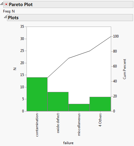

Figure 13.8 Pareto Plot with a Threshold Count of 2
Figure 13.8 displays the plot after specifying a count of 2. All causes with counts 2 or fewer are combined into the final bar labeled 4 Others.

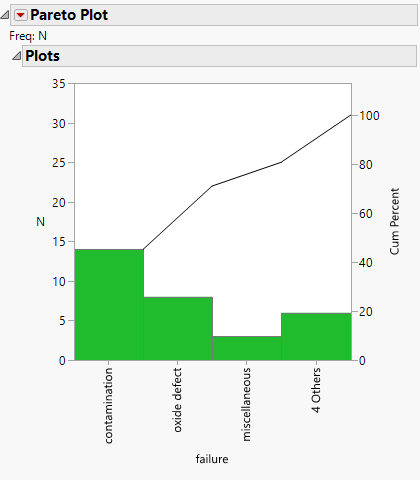

8. To separate the combined bars into original categories as shown in Figure 13.9, select Causes > Separate Causes.
Figure 13.9 Pareto Plot with Separated Causes
