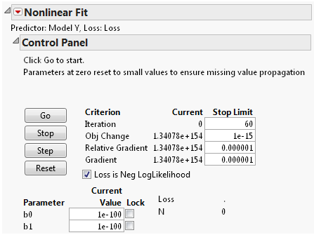

The Nonlinear Fit Control Panel appears.
Figure 15.13 Nonlinear Fit Control Panel
6. Click Go.
