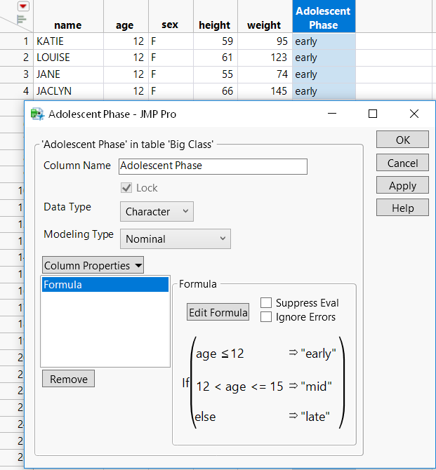

How do you create a formula column that combines conditional expressions with value comparisons? Create a Formula Column.jsl shows how to create a new formula column that evaluates ages in Big Class.jmp and returns the result in the new column (Figure 17.3).

/* Create a new character column for the formula.
Insert "early" in the new column if the age is less than or
equal to 12. Insert "mid" if the age is less than or equal to
15 but greater than 12. For ages greater than 15, insert "late".
dt << New Column( "Adolescent Phase",
	Character,
	Formula(
		If( :age <= 12, "early",
			12 < :age <= 15, "mid",
			"late"
Figure 17.3 Conditional Expression in Formula
