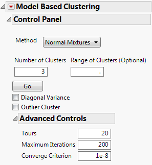

The Control Panel for the Cytometry.jmp data table, with the variables CD3 through MCB as Y, Columns, is shown in Figure 14.5. You can fit various numbers of clusters using the Control Panel iteratively or you can specify a range using the Range of Clusters option.
Figure 14.5 Control Panel for Normal Mixtures Method
