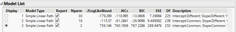

The Model List report gives summary statistics and other options for every fitted model. Figure 7.17 shows an example of the Model List with summaries for three models.
Figure 7.17 Model ListĀ
Model List
Display
Select the model that you want represented in the Overlay plot, Residual Plot, Inverse Prediction plot, and Prediction Graph.
Model Type
Gives the type of path, either linear or nonlinear.
Report
Select the check boxes to display the report for a model. For more information about the reports, see Reports.
Nparm
Gives the number of parameters estimated for the model.
-2LogLikelihood
Gives twice the negative of the log-likelihood. See Likelihood, AICc, and BIC in Fitting Linear Models.
AICc
Gives the corrected Akaike Criterion. See Likelihood, AICc, and BIC in Fitting Linear Models.
BIC
Gives the Bayesian Information Criterion. See Likelihood, AICc, and BIC in Fitting Linear Models.
SSE
Gives the error sums-of-squares for the model.
DF
Gives the error degrees of freedom.
Description
Gives a description of the model.
