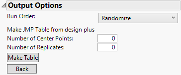

Specify details for the output data table in the Output Options panel. When you have finished, click Make Table to construct the data table for the design. Figure 9.17 shows the Output Options panel for a standard design selected from the Design List. For a main effects screening design, only Run Order is available.
Figure 9.17 Select the Output Options
Run Order
The Run Order options determine the order of the runs in the design table.
Keep the Same
Rows in the design table are in the same order as in the Coded Design or Design outlines.
Sort Left to Right
Columns in the design table are sorted from left to right.
Randomize
Rows in the design table are in random order.
Sort Right to Left
Columns in the design table are sorted from right to left.
Randomize within Blocks
Rows in the design table are in random order within the blocks. (Not available if you select Construct a main effects screening design.)
