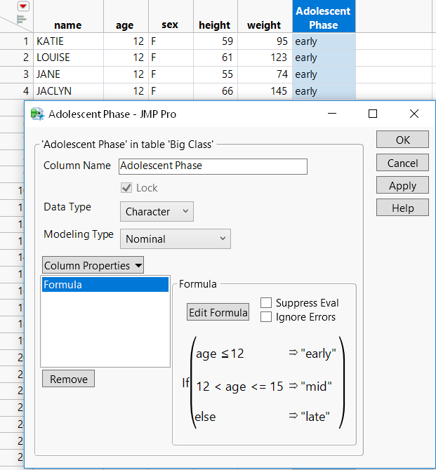

In JMP, you can create a formula column that combines conditional expressions with value comparisons. Create a Formula Column.jsl shows how to create a new formula column that evaluates ages in Big Class.jmp and returns the result in the new column (Figure 17.3).

Figure 17.3 Conditional Expression in Formula
