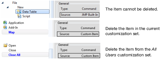

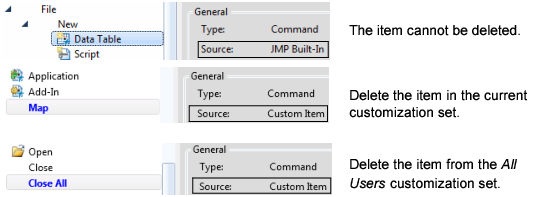

Rather than temporarily showing or hiding toolbars, buttons, menus, and menu items, you can delete items that you created to remove them permanently from JMP. The Source determines whether you can delete the item and which customization set contains the item. Figure 13.4 shows examples of customization Source types.
Figure 13.4 Examples of Customization SourcesĀ
