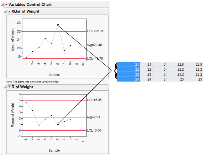

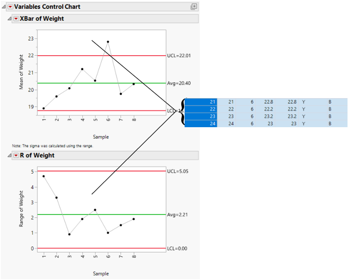

Figure 14.2 Variables Charts for Coating Data
An XBar chart and an R chart for the process are shown in Figure 14.2. Sample six indicates that the process is not in statistical control. To check the sample values, click the sample six summary point on either control chart. The corresponding rows highlight in the data table.
