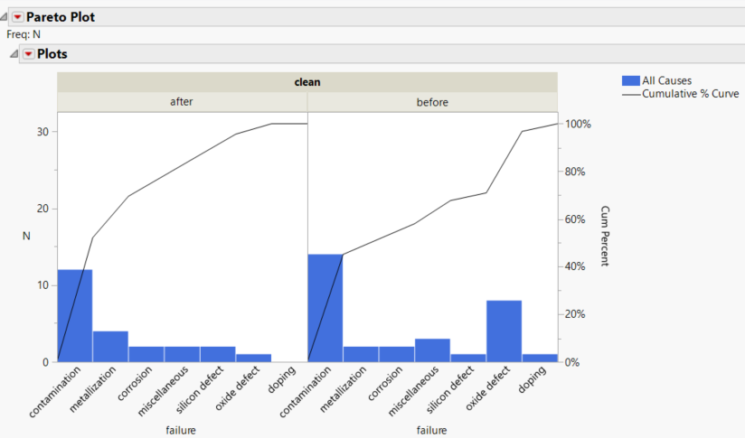

Figure 15.13 One-way Comparative Pareto PlotĀ
There is a plot for each value of the variable clean. The horizontal and vertical axes are scaled identically for both plots. The bars in the first plot are in descending order of the Y axis values and determine the order for all cells.

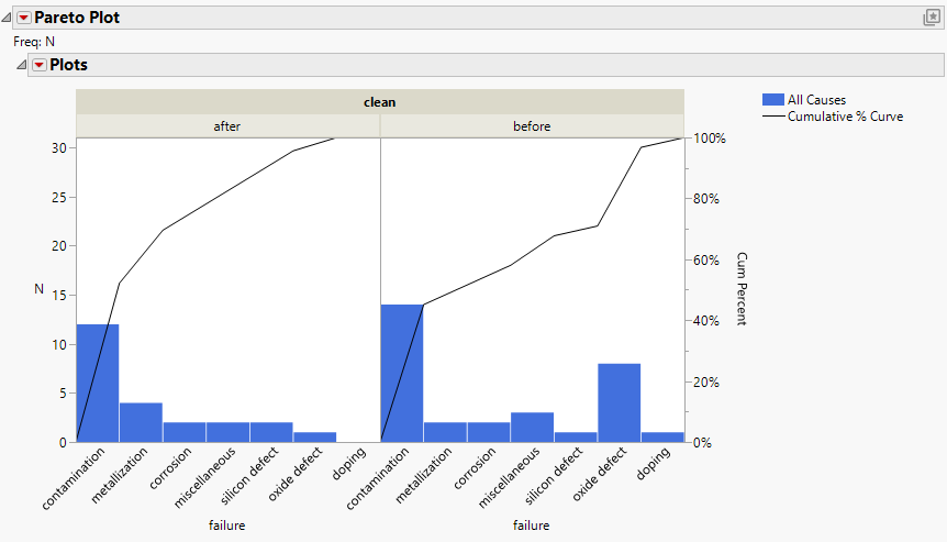

7. Click the Plots red triangle and select Reorder Horizontal.
8. Click the down arrow once and then click OK.
This rearranges the order of the plots.
Figure 15.14 One-way Comparative Pareto Plot with Reordered CellsĀ
The plots are easier to interpret when presented as the before-and-after plot shown in Figure 15.14. Note that the order of the causes changes to reflect the order based on the first cell. A comparison of these two plots shows a reduction in oxide defects after cleaning.
