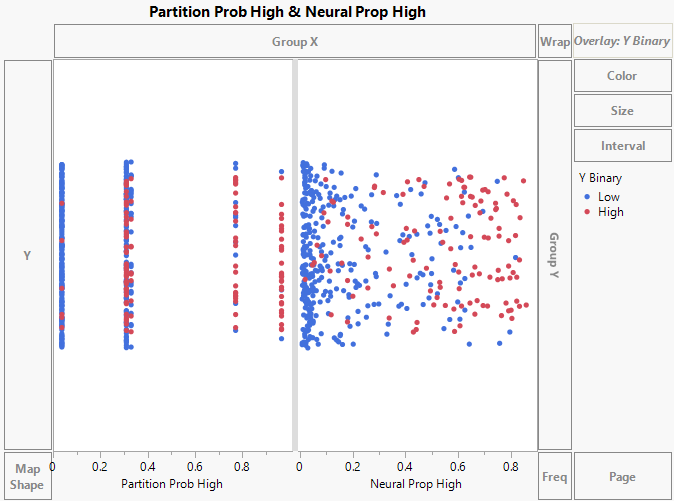

1. Select Graph > Graph Builder.
2. Select Partition Prob High and drag it to the X zone.
3. Select Neural Prob High and drag it to the X zone, to the right of Partition Prob High. This creates a second X axis.
Figure 4.18 Drag Neural Prob High to the Right of Partition Prob High
4. Select Y Binary and drag it to the Overlay zone.
5. Click the Graph Builder red triangle and select Graph Spacing.
6. Type 6 next to Graph Spacing and click OK.
This increases the spacing between the two X axes.

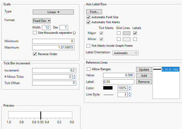

1. Right-click the Partition Prob High X axis and select Axis Settings.
2. In the Scale section, click the box next to Reverse Order.
3. In the Tick/Bin Increment section, set # Minor Ticks to 2.
4. In the Reference Lines section, type 0.50 in the boxes next to Value and Label.
5. In the box next to Line Style, enter 3. The 3 indicates the thickness of the reference line.
6. Click Add.
Figure 4.20 X Axis Settings
X Axis Settings

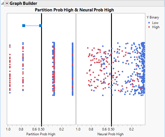

7. Click OK.
8. Right-click on the Partition Prob High X axis and select Edit > Copy Axis Settings. Right-click on the Neural Prob High X axis and select Edit > Paste Axis Settings.
9. Click Done.

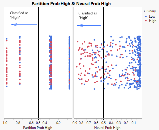

Annotate the Graph
1. In the main menu, click Tools > Line. Draw a horizontal line to the left of the reference line in the Partition Prob High graph.
Figure 4.21 Line Drawn to the Left of the Partition Prob High Reference Line
2. Right-click the line and select Point to.
The arrow should be pointing away from the reference line.
3. In the main menu, click Tools > Annotate and click on the graph above the arrow.
4. Type Classified as “High” in the text box. See Figure 4.22.
5. Repeat step 1 through step 4 in the Neural Prob High graph.
Figure 4.22 Distribution of Predicted Probabilities
The graph shows that the distribution of the predicted probabilities differs between the two models. The partition model has five predicted score levels while the neural model scores are dispersed across the score range. For both models, there is a cluster of blue data points on the far right of each plot. These are low subjects that both models classify correctly as they fall to the right of the threshold.
