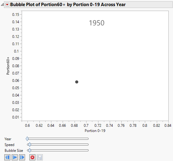

6. Click OK.
Figure 5.7 The Initial Report Window with a Time VariableĀ
7. Click the bubble to select it.
All rows in the data table are also highlighted.

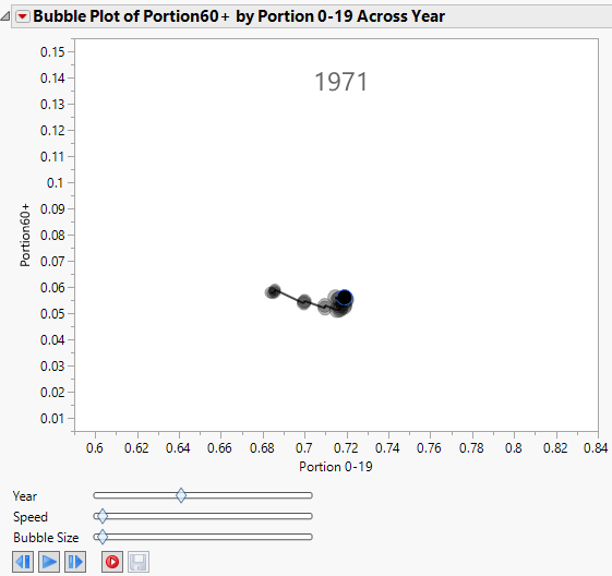

8. Click the Bubble Plot red triangle and select Trail Bubbles > All and Trail Lines > All.
9. Click the play button.
The bubble plot animates, showing a trail for the single bubble.
Figure 5.8 Animated Bubble Plot over TimeĀ
