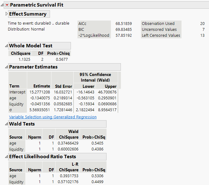

Figure 15.14 Tobit Model Results
Tobit Model Results
The report shows the estimated Tobit model fit. Note in the upper right part of the report that there are 13 left-censored observations. This is a good way to check that you have correctly specified the left censoring.
