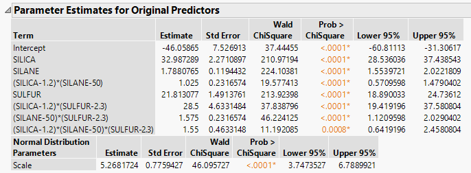

Figure 3.35 Parameter Estimates From Generalized Regression Report

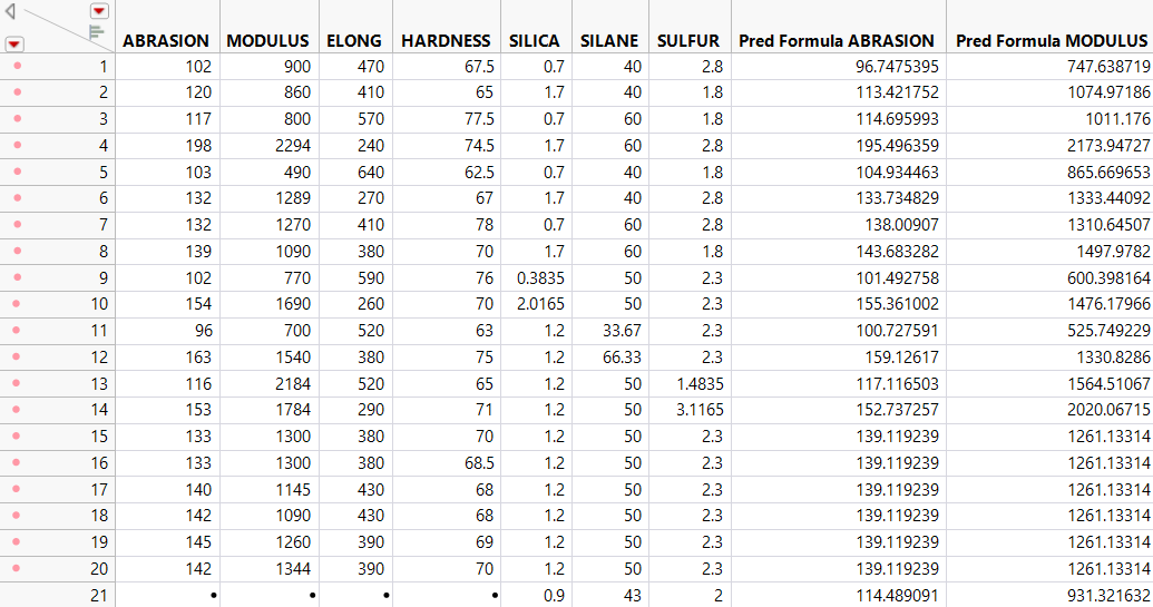

Return to the data table. For each response variable, there are three new columns denoted as Pred Formula <colname> Bagged Mean, <colname> Bootstrap Std Err, and StdError <colname> Bagged Mean. The Pred Formula ABRASION Bagged Mean column is the final prediction.
Prediction for a New Observation
You now have predictions for ABRASION for each observation in the data table, as well as the standard errors for those predictions. Suppose that you have an observation with new values of 0.9, 43, and 2 for SILICA, SILANE, and SULFUR, respectively. You can predict the ABRASION response and obtain a confidence interval for that prediction because the Save Prediction Formulas option saves the regression equation for each bagged model. Therefore, M predictions are made with the new factor values to create a distribution of possible predictions. The mean is the final prediction, but analyzing the distribution tells you how accurate the prediction is.

All of the prediction columns for the new row are automatically calculated.
Figure 3.36 Values for New Row
Values for New Row

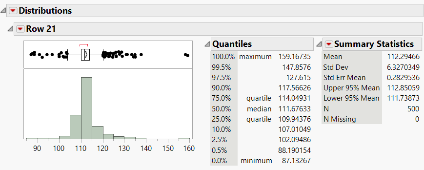

9. Select Analyze > Distribution.
10. Select Row 21 and click Y, Columns.
Note: Row 21 corresponds to the predictions from the new observation.
11. Click OK.
12. Click the red triangle next to Row 21 and select Display Options > Horizontal Layout.

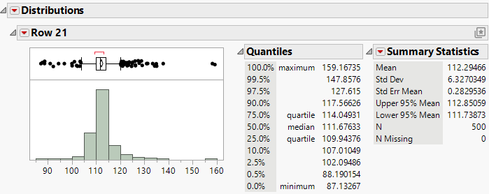

Figure 3.37 Distribution Report
Distribution Report
The Distribution Report in Figure 3.37 contains information about the distribution of the predicted values of ABRASION from each bagged model. The final prediction of ABRASION for the new observation is 112.3, which is the mean of all the M bagged predictions. This prediction has a standard error of 6.33. You can also create confidence intervals for the new prediction using the quantiles. For example, a 95% confidence interval for the new prediction is 102.09 to 127.62.
