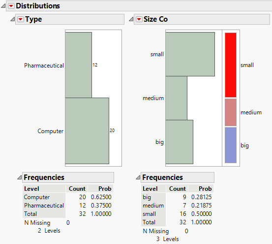

3. Select both Type and Size Co and click Y, Columns.
4. Click OK.
5. Click the Type red triangle and select Histogram Options > Show Counts.
6. Click the Size Co red triangle and select Mosaic Plot.

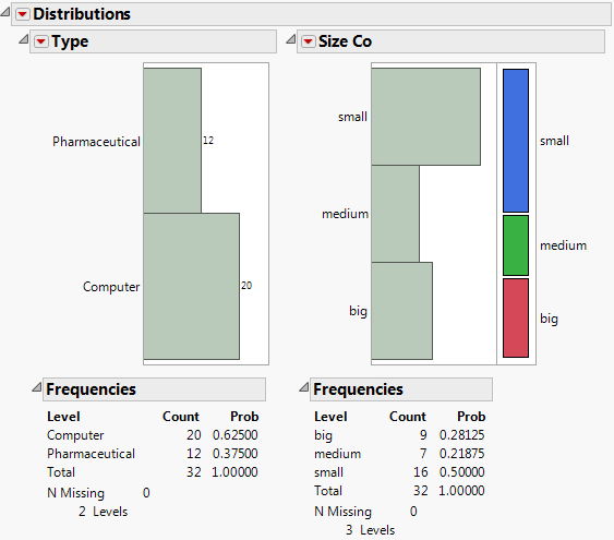

7. Select Edit > Journal to journal these results. The results are duplicated in a journal window.
Figure 7.11 Journal of Distribution ResultsĀ
The results in the journal are not connected to the data table. In the Type bar chart, if you click the Computer bar, no rows are selected in the data table.
