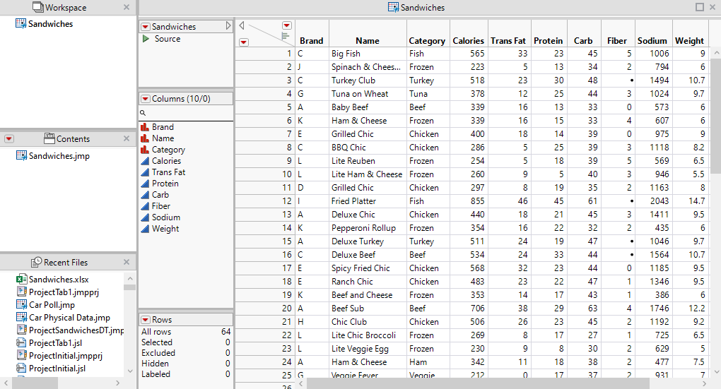

1. Select File > New > Project (Windows) or File > New > New Project (macOS).
2. From the project window, select File > Open.
3. Open the sandwiches.xlsx file, located here by default:
C:\Program Files\SAS\JMP\17\Samples\Import Data
Tip: At the bottom, you might need to change All JMP Files to Excel Files.
4. Click Import.
5. Select File > Save.
6. Make sure Project Contents is selected.
7. Change the file name to Sandwiches.jmp and click Save.
Figure 10.26 Project with Sandwiches Data Imported

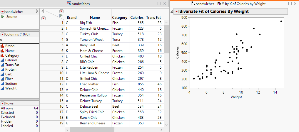

8. Select Analyze > Fit Y by X.
9. Select Calories and click Y, Response.
10. Select Weight and click X, Factor.
11. Click OK.
12. Drag the Sandwiches - Fit Y by X tab to the right and drop it into the Dock right zone.
Tip: To show the entire report, you can drag the line between the data table and the report to the left.
Figure 10.27 Fit Y by X (Bivariate) Report Docked at Right

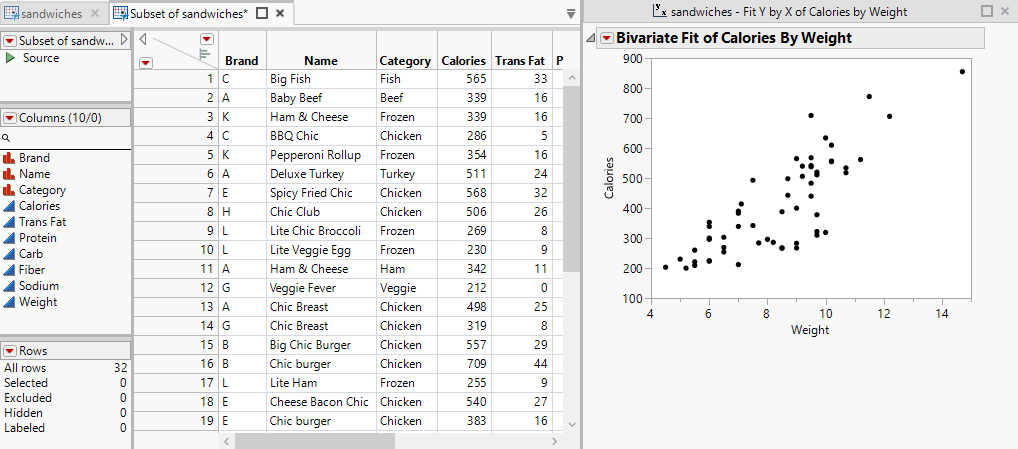

13. Select Tables > Subset.
14. Under Rows, select Random: sampling rate 0.5.
15. Click OK.
Figure 10.28 Project with Unsaved Subset Table
