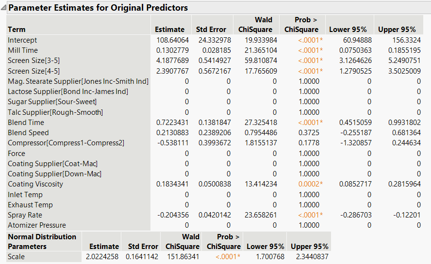

Figure 10.13 Model Based on Adaptive Lasso
You are interested in the parameter estimates shown in the Normal Adaptive Lasso with AICc Validation report. Based on the nonzero parameter estimates, the model suggests that Mill Time, Screen Size, Blend Time, Blend Speed, Compressor, Coating Viscosity, and Spray Rate are related to Dissolution.

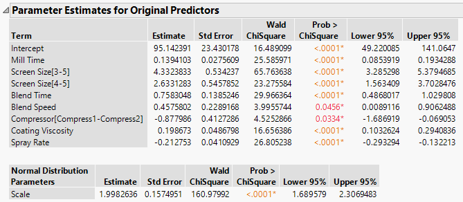

Figure 10.14 Reduced Model Using Adaptive Lasso
Notice that the estimate for Blend Speed has a confidence interval (Lower 95%) that comes very close to including zero. Next, perform a simulation study to see how often Blend Speed would be included in the model if other data values from the dissolution distribution have been observed.

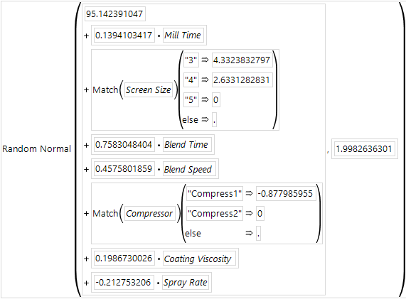

1. Click the red triangle next to Normal Adaptive Lasso with AICc Validation and select Save Columns > Save Simulation Formula.
This adds a new column called Dissolution Simulation Formula to the Tablet Production.jmp data table.
2. (Optional) In the data table Columns panel, click the plus sign to the right of Dissolution Simulation Formula.
Figure 10.15 Simulation Formula
Simulation Formula
For each row, this formula simulates a value that could be obtained given the model and the distribution of Dissolution, which is estimated to be Normal with standard deviation about 1.998.

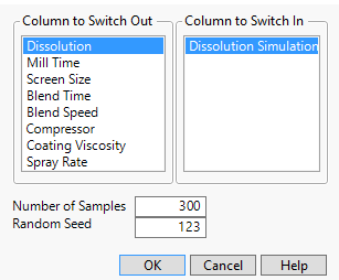

4. Go back to the reduced model report window. In the Parameter Estimates for Original Predictors report, right-click in the Estimate column and select Simulate.
Make sure that Dissolution is selected in the Column to Switch Out list.
5. Next to Number of Samples, enter 300.
For the simulation, you ask JMP to replace the Dissolution column in each of 300 analyses with values simulated using the Dissolution Simulation Formula column.
6. (Optional) Set the Random Seed to 123.
This reproduces the values in this example.
Figure 10.16 Completed Simulation Window
7. Click OK.

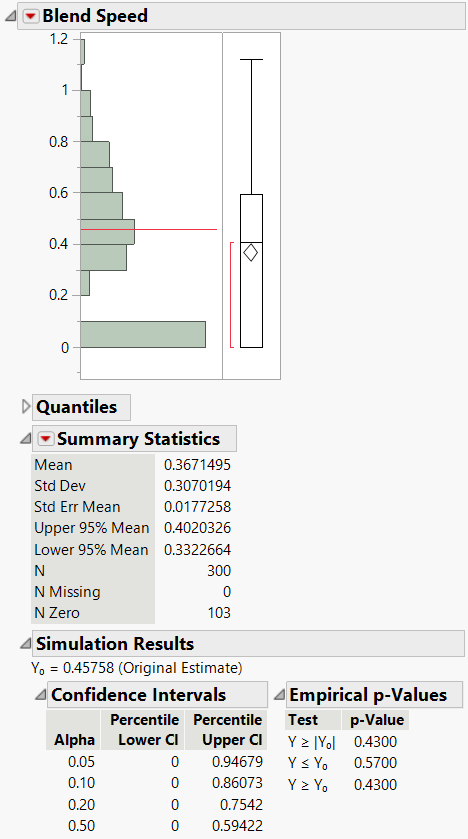

8. Run the Distribution script.
9. Press Ctrl, click the Blend Speed red triangle and select Display Options > Customize Summary Statistics.
10. Select N Zero.
11. Click OK.

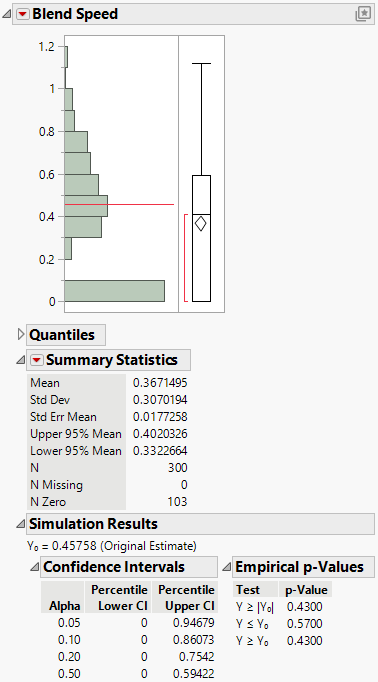

12. Scroll to the Distribution report for Blend Speed.
Figure 10.17 Histogram of Simulated Blend Speed Coefficient Estimates
The Summary Statistics report shows that for 103/300 = 34.3% of the simulations, the Blend Speed estimates are zero.
