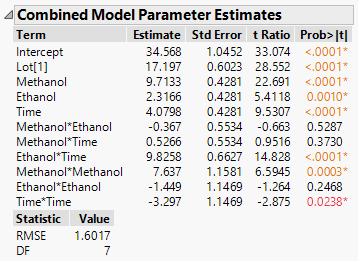

The effects selected for the model are listed in the Combined Model Parameter Estimates report.
Figure 9.4 Combined Model Parameter Estimates Report
The RMSE and degrees of freedom given at the bottom of the report are the usual standard least squares quantities. Use these effects as potential factors for your final model.

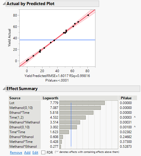

1. Click Run Model.
The Actual by Predicted Plot shows no lack of fit. The Effect Summary report suggests that you can reduce the model further.
Figure 9.5 Actual by Predicted Plot and Effect Summary Report
2. Select Methanol*Ethanol in the Effect Summary report and click Remove.
Methanol*Time has p-value 0.33750. Remove it next.
3. Select Methanol*Time in the Effect Summary report and click Remove.
Ethanol*Ethanol has p-value 0.15885. Remove it next.
4. Select Ethanol*Ethanol in the Effect Summary report and click Remove.

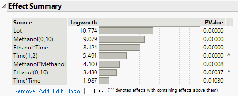

Figure 9.6 Effect Summary Report Showing Effects in Final Model
The remaining effects are significant. You conclude that these are the active effects.
