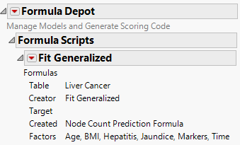

Image shown hereExample of the Formula Depot
This example uses an existing script in a sample data table to generate a model and then publishes the prediction formula from the model to the Formula Depot. The data table contains data on the severity of liver cancer in patients when they entered a study.

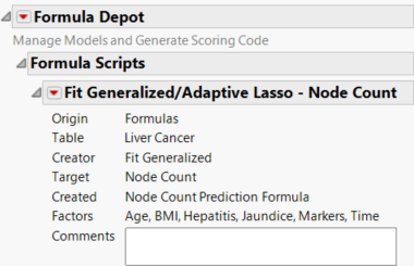

Figure 13.2 Formula Depot with a Generalized ModelĀ
