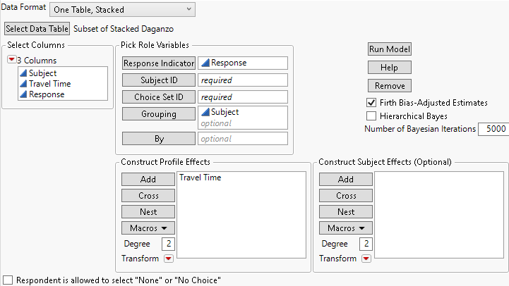

12. Select Analyze > Consumer Research > Choice to open the launch window and specify the model as shown in Figure 4.54.
Figure 4.54 Choice Dialog Box for Subset of Stacked Daganzo Data for One-Table Analysis

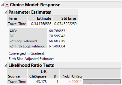

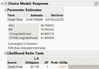

Figure 4.55 Parameter Estimate for Travel Time of Daganzo Data from One-Table Analysis
Notice that the result is identical to that obtained for the two-table model, shown earlier in Figure 4.51.
