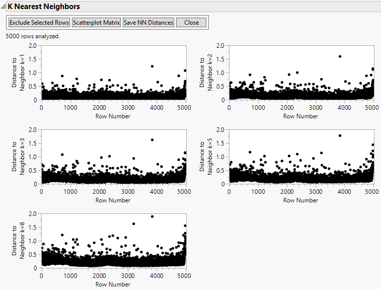

Figure 21.1 Multivariate k-Nearest Neighbor Outlier Example
