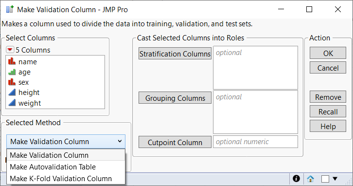

Launch the Make Validation Column platform by selecting Analyze > Predictive Modeling > Make Validation Column.
Figure 12.3 Make Validation Column Launch Window
The Make Validation Column launch window provides the following options:
Stratification Columns
Assigns one or more stratification columns.
Grouping Columns
Assigns one or more categorical grouping columns.
Cutpoint Column
Assigns a numeric cutpoint column.
Cutpoint Batch ID
When a cutpoint column is assigned, you can also assign a column for cutpoint batch IDs. This enables you to determine cutpoint values within each level of the Cutpoint Batch ID column.
